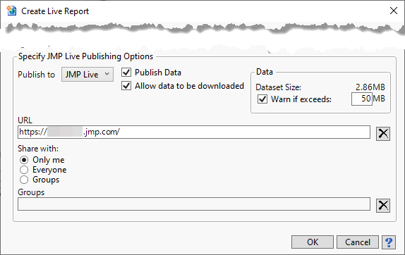

The Create Live Report dialog is surfaced.
The Create Live Report dialog.The Create Live Report dialog.
Click Publish to JMP Live to allow for maximum interactivity, server-side recomputing power, and sharing. Click Publish to File to save a less interactive copy to your machine alone.
Clicking Publish Data sends a copy of underlying JMP data tables to JMP Live, which is recommended for maximum interactivity.
With Allow data to be downloaded, JMP Live users can download the data tables and scripts.
By checking Warn if exceeds: and specifying a value,  JMP Clinical will warn you if the estimated data set size sent for publishing exceeds a size of your choice. This feature helps you avoid unnecessary publish attempts if your JMP Live administrator has specified a maximum package size that is smaller than the sum of data set sizes that you are attempting to publish.
Specify a URL to the JMP Live instance.
You can choose to Share with: Only me (yourself), Everyone at your organization who has access to JMP Live, or only specific Groups of JMP Live users at your organization.
Note that the settings in this dialog are retained for the next time you click Create Live Report.

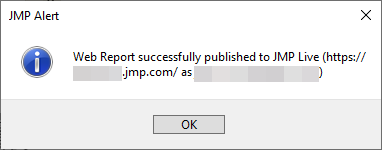

Click OK to publish to JMP Live.
A notification window appears, indicating if the operation was successful.
Notification window for successful publish to JMP Live.Notification window for successful publish to JMP Live.

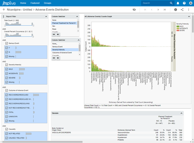

On the analysis pages, data filters, column switchers, hover labels and platform-specific controls allow for interactive exploration of the results.
Adverse Events Distribution in JMP Live.Adverse Events Distribution in JMP Live.

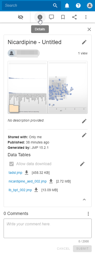

Click the Details button to view or edit the title, description and thumbnail, to view or download data tables, and write comments.
The Details pane in JMP Live.The Details pane in JMP Live.
