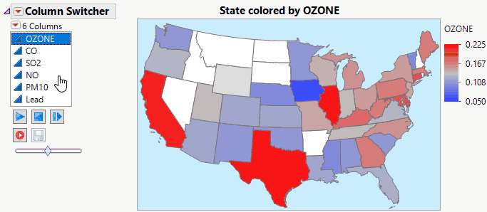

The Column Switcher in JMP lets you quickly analyze different variables without having to recreate your analysis. When a variable is changed with the Column Switcher, the analyses are recomputed with the new variable.

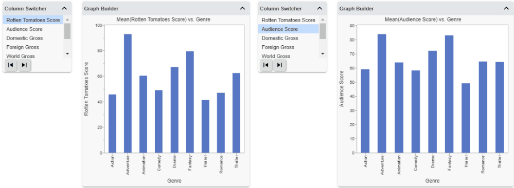

If you expect your audience to have a wide screen, you can use two Column Switchers in a way that helps them compare variables side by side. Click on the animated gif image to explore this in a separate window.
