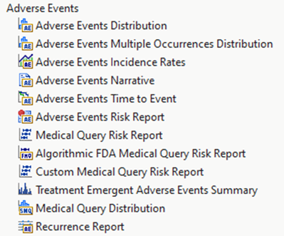

Given how important AEs are to patient safety, it is no wonder why JMP Clinical contains so many reports dedicated to their analysis and summary (Figure 1).
Figure 1. Reports dedicated to adverse eventsFigure 1. Reports dedicated to adverse events
Given so many options for analyzing AEs, the user is often faced with the question “What report should I use?” That’s a great question! Not only does JMP Clinical analyze individual AEs, but it can also analyze various groupings of events as well, using Standardized MedDRA Queries (SMQs) and FDA Medical Queries (FMQs). So, without further ado, let’s see what JMP Clinical can do (Table 1).
