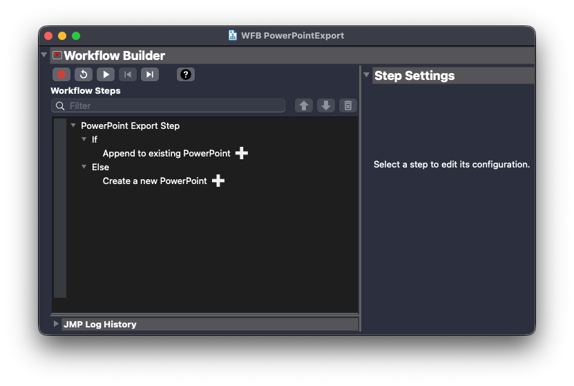

In JMP 18, Workflow Builder added support for if/else statements and messages, among other things. These two capabilities, along with some obscure JSL, are how I was able to get this working. (Sidebar: The JMP Scripting Index is your friend, folks!)
In my head, I wanted this step to include exporting a new presentation file or using the Append option for the Save Presentation() function to add a slide to an existing presentation. That meant two things: first, I’d need a dialog to change course between the two versions of the Save Presentation() step, and second, I’d need a way to switch between them.

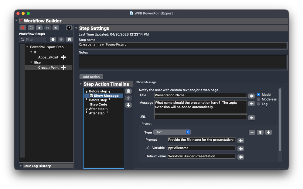

The logic for each step is straightforward. Add the if and else steps from the advanced menu when you click on the red triangle in a Workflow Builder and put messages in each step in the “At Start” slot of the Step Action Timeline. Next, edit the condition script to match the variables set up in the messages. I’ve put a brief video below showing the steps for each
(view in My Videos)

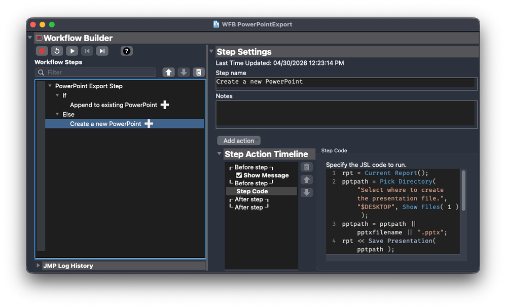

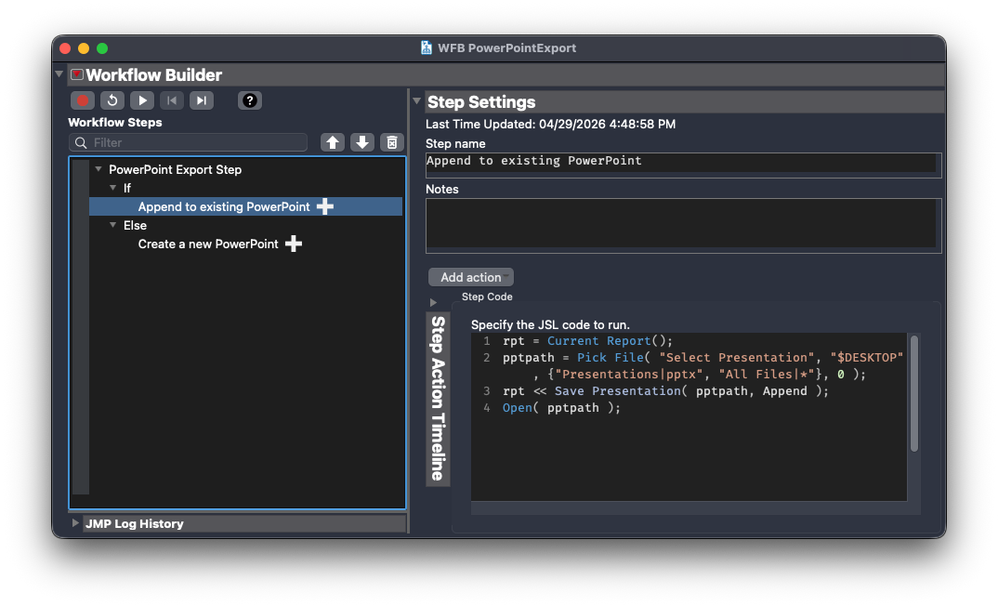

After the if and else are set up, we can go back to the advanced red triangle submenu, add custom steps, and move them into the if and else steps. I’ve changed the name in the screenshot so that it’s clear what each does.
Here are screenshots of the custom process needed in the append step:
And the steps for a new presentation:
The magic in making this work as a general solution can be found in the JSL for the custom steps, specifically the Current Report() function. Thanks to my early education in JSL (shoutout to Di Michelson on the JMP Education team!), I know that JMP will automatically perform actions on the current window or object unless I specifically direct it otherwise. I also know that the last created object will always be the current one unless my code does something to change that. So, if I put the step I’m constructing (meaning the if/else group) after I create a report, the Current Report will be the report I just created. And the Current Report() function will return a reference to that report. I can then pass that reference to Save Presentation by just using the variable holding the report reference.
The Pick File() and Pick Directory() automatically generate dialogs and return paths. Using these two ideas together in the Save Presentation() argument mean that I can know which report to act on based on the step location in the workflow. I can also ask the user which presentation they want me to update or where they want me to create one.

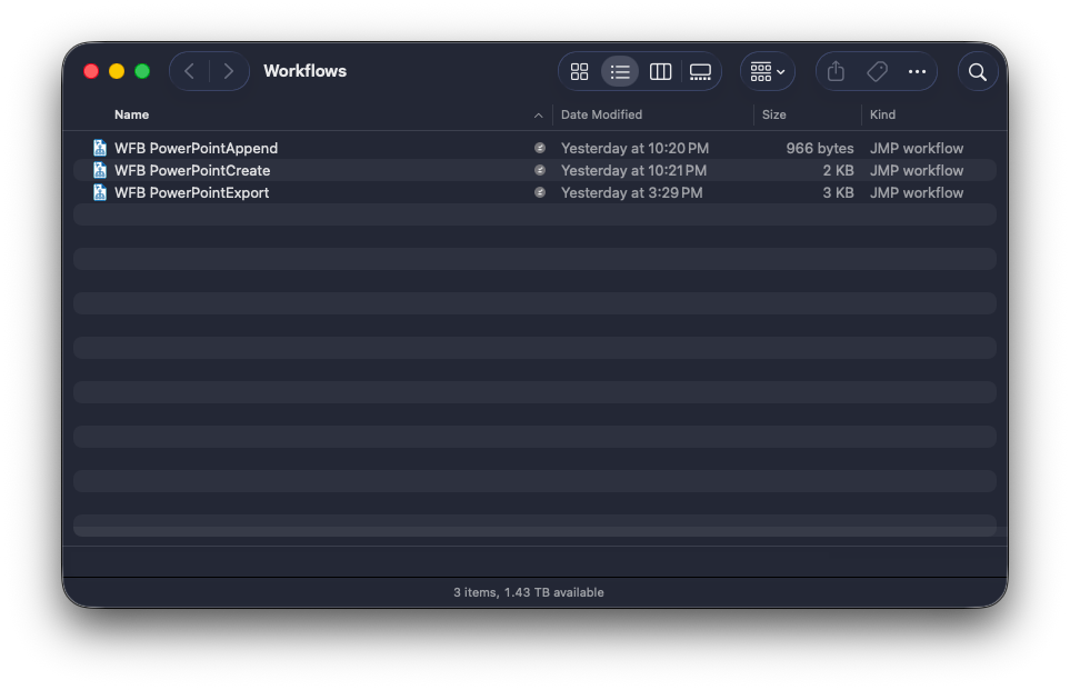

For those who skipped the coding section, welcome back! Let’s have a look at what is in the zip file from the downloads section for this article. Inside, you’ll find three files:
The PowerPointExport file is a standalone Workflow Builder step can both append or create a new presentation file. The other two work together and are for a specific case I’ll detail in a moment. To start, let’s look at a simple case. I’ve created a short video to show the steps:
