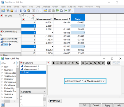

Ever been confused by the result when trying to add numeric values using a plus (+) operator? Maybe you discovered the Sum() function to get around the problem but never really understood why it worked. In this blog post, I explain the Add() function, plus (+) operator, and the Sum() function to help you get the results you need from your script or column formula.

But what if one of the values is a numeric missing (.)? The Add() function will return missing if any of the arguments is a missing value.
In the previous example, the result was 3 for either expression. Building on that, if a missing value was one of the arguments, then it would return missing, rather than 3.
1 + . + 2;  //Returns missing
Add( 1, ., 2 );  //Returns missing
So how do you still obtain a total value excluding the missing values? This is where the Sum() function comes in. The Sum() function will also add values to calculate a total value, however, it ignores missing values.
