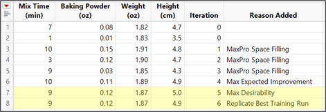

Using two initial trials as historical data, six iterations of Bayesian optimization were required to reach an optimal mix time and baking powder amount. See the data table below:

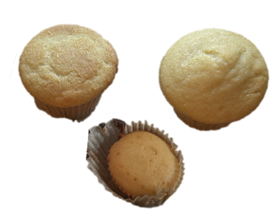

The best iterations from Bayesian optimization: mixing eggs and sugar for nine minutes, paired with 0.12 ounces of baking powder. Experimental runs with these amounts yielded the tall cupcakes with a reduced weight.
The winner (with icing)!The winner (with icing)!
Cupcakes from experimental runs. Notice the height differences, which are between 0.8-1.5 cm.Cupcakes from experimental runs. Notice the height differences, which are between 0.8-1.5 cm.
