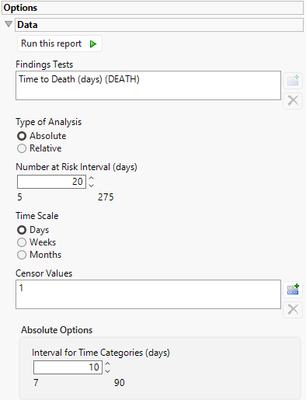

Dynamic Survival uses the JMP Survival  and Fit Proportional Hazards platforms to analyze a single endpoint from the ADTTE domain. Essentially, the Survival and Fit Proportional Hazards platforms analyze the TTE endpoint separately for distinct time categories that are produced according to the type of analysis requested by the user: Absolute or Relative (default).

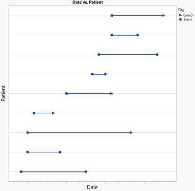

For example, suppose we observe TTE data plotted by patient and date (Figure 3). Each patient’s time is measured from a start date to an end date where the patient experiences an event or is censored for not having experienced an event prior to the end of their follow-up.
Figure 3. Absolute analysis conducted by dateFigure 3. Absolute analysis conducted by date

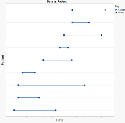

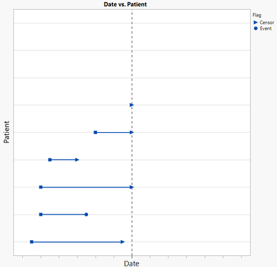

Suppose there was interest in conducting an interim analysis at a date indicated by the dashed horizonal reference line (Figure 4). For this analysis, patients whose follow-up extends beyond this reference date would be censored at this date (Figure 5). This interim analysis conducted using the data from Figure 5 would include six patients, only one of whom had an event prior to the reference date.
Figure 5. Absolute analysis with patients censored at reference dateFigure 5. Absolute analysis with patients censored at reference date

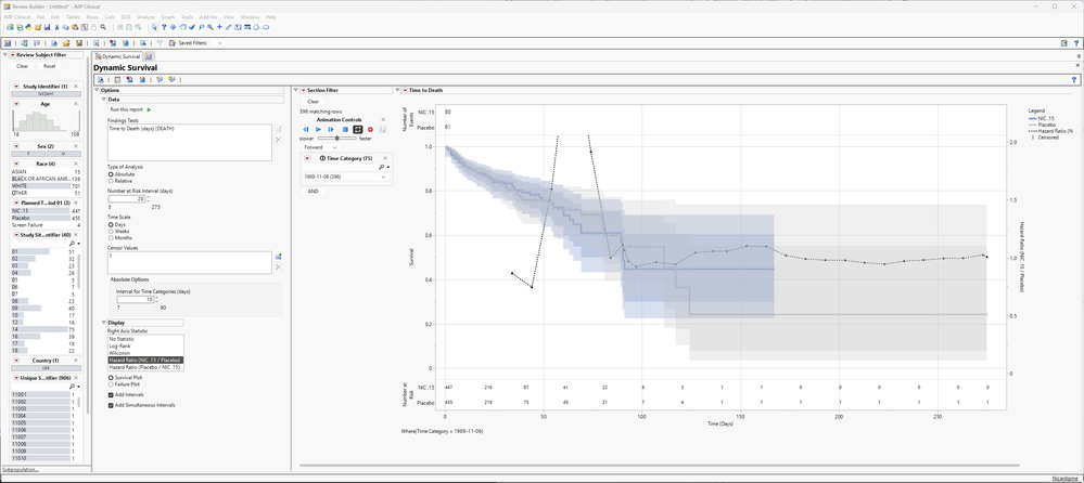

Figure 6 is an Absolute analysis of the Nicardipine Time to Death endpoint from ADTTE. At the top of the figure, the total Number of Events experienced for each arm is summarized; the bottom of the figure presents a table for the Number of Patients at Risk in 20-day increments (Number at Risk Interval, Figure 2).
Figure 6. Absolute analysis of NicardipineFigure 6. Absolute analysis of Nicardipine
The Section Filter enables the user to select a Time Category date according to the maximum event/censor date and Interval for Time Categories (10 days were used, as in Figure 2). If it is of interest, the user can select “Time Category” in the filter and use the animation controls to play an animation of how the TTE analysis will change over time. The Right Axis Statistic will plot either of the p-values (from the Survival platform) or hazard ratios (from the Fit Proportional Hazards platform) by adding a second Y-axis. The button Failure Plot changes the survival plot to a failure plot, where the Y-axis starts at 0 and increases upward as events occur; Add Intervals will add 95% confidence bands around the KM curves; Add Simultaneous Intervals will add 95% simultaneous confidence bands around the KM curves. For example, Figure 7 shows both confidence bands and the NIC.15 vs Placebo hazard ratio across time for data based on the Time Category 1988-12-11, which summarizes data through roughly half of the total observed follow-up. Notice how the sample size is reduced to roughly half of the starting sample size, 254 and 261 on NIC.15 and Placebo, respectively. In this summarized data, 49 and 44 events are experienced on the NIC.15 and Placebo arms. And we can assess the robustness of the hazard ratio to accumulating data across time.

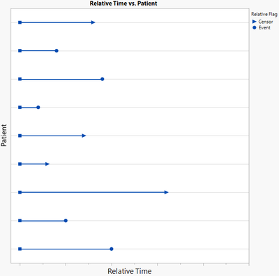

In contrast to the Absolute analysis described in Figure 3, the Relative analysis (Figure 8) considers time within each patient relative to their start dates. Therefore, all patients start at time 0 and will end at the number of days to reach their event/censor date.
Figure 8. Relative analysis conducted by relative timeFigure 8. Relative analysis conducted by relative time

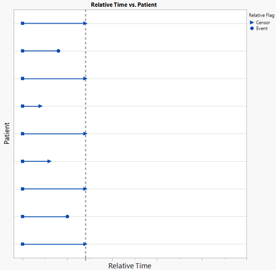

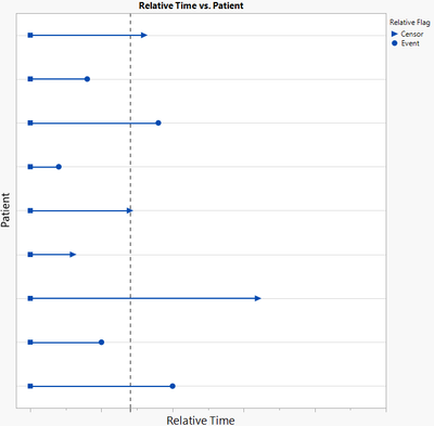

In a manner similar to the Absolute analysis, suppose there was interest in conducting an analysis at a Relative time indicated by the dashed horizonal reference line (Figure 9). For this analysis, patients whose follow-up extends beyond this reference time would be censored at this time (Figure 10). Unlike the Absolute analysis, this analysis would include every patient, since every patient is included in the analysis since time 0.
Figure 10. Relative analysis with patients censored at reference timeFigure 10. Relative analysis with patients censored at reference time

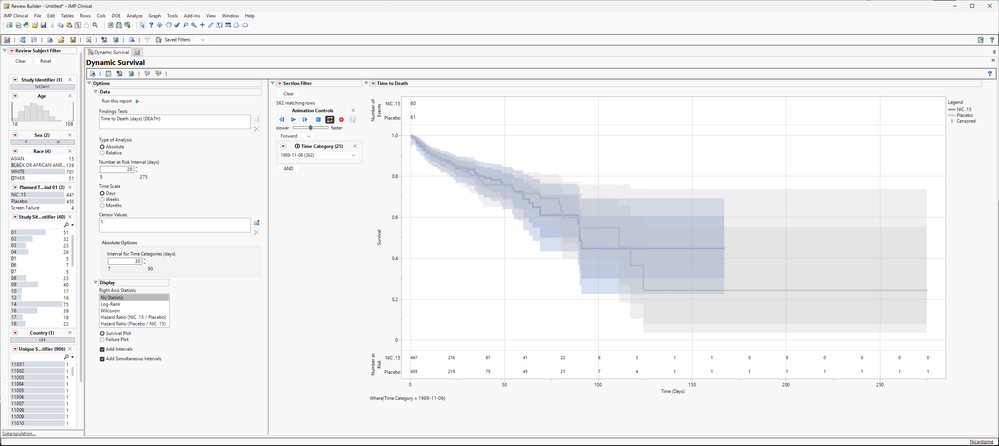

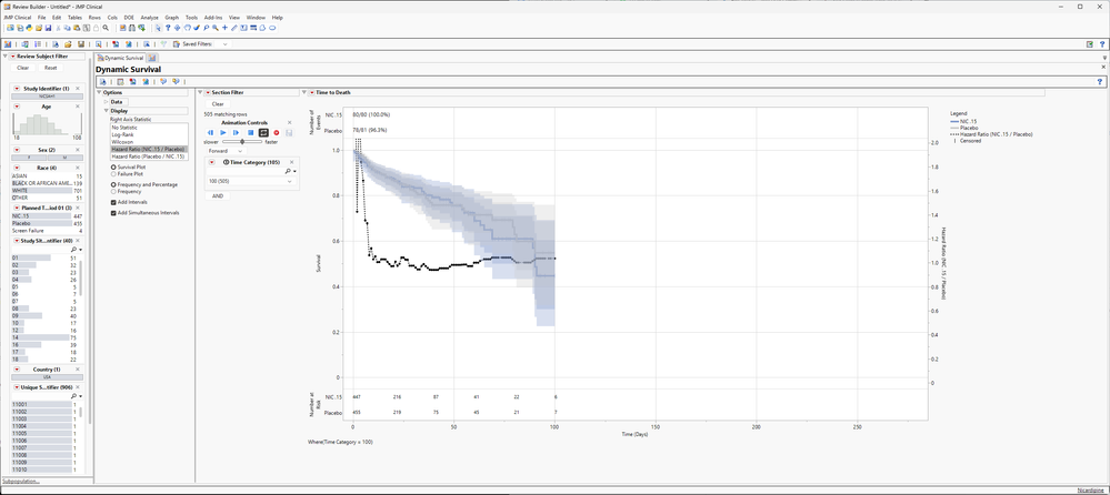

Figure 11 shows a Relative analysis for Nicardipine for Time Category 100 (which can be thought of as 100 days of follow-up from Time 0, usually when the patient starts dosing). Both confidence intervals have been added to the figure, as well as a line for the hazard ratio for Nicardipine vs. Placebo. By day 100, there are seven patients still at risk for each treatment arm, and the initial sample sizes coincide with the total sample sizes of treated patients in each arm. Notice that the Number of Events includes the proportion of Total Events experienced for each arm. By day 100, all 80 events have been experienced on the NIC.15 arm, and 78 of 81 events (96.3%) have been experienced on Placebo, indicating that there are three events left to occur by the end of the analysis. A Relative analysis makes it possible to view an animation and watch as the proportion of events grows over time. Admittedly, the animation can be seen as a bit frivolous, but it certainly can create some drama in the communication of positive study results to the team.
