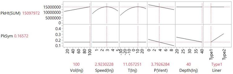

What if I have more than one response?
So far in our example, we have been looking at only one response, PkHt(SUM). Most of the time when you have a process or system that you need to understand, there will be more than one response to think about. With many responses to understand and optimise there is an even stronger need for the efficiency and effectiveness of DoE.
This case is no different. For reliable detection of impurities with our GC-MS system, we need peaks that are both big and symmetrical. So, as well as the PkHt(SUM) response, we also have a measure of the symmetry of the peaks, PkSym, for each run of the experiment.
 Data table for 26-run experiments with two responses.
We want PkSym to be as low as possible and the ideal value is 0, which would mean that the peaks for every analyte are perfectly symmetrical.
Having collected the response data for each run, we can build models and find the best compromise to meet all objectives.
The optimal settings to maximise peak height and quality can be found from modelling the data from the 26-run experiment.
You can see how the DoE advantage is even greater when you have multiple response objectives.
