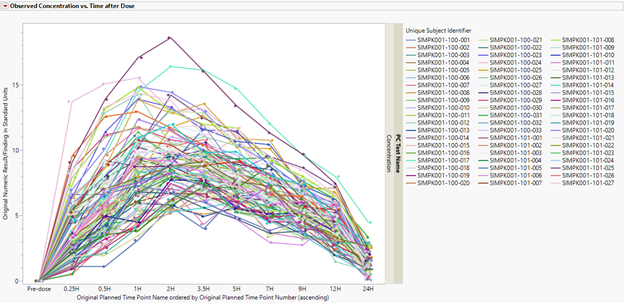

The second major set of options determines how graphics are plotted, using either the planned time point or the observed time point. By default, the report uses Linear to regression start, then log-linear and Planned Time. Figure 1 displays observed concentrations for the Theophylline data by the planned time after dose.
Figure 1. Observed concentrations by timeFigure 1. Observed concentrations by time
