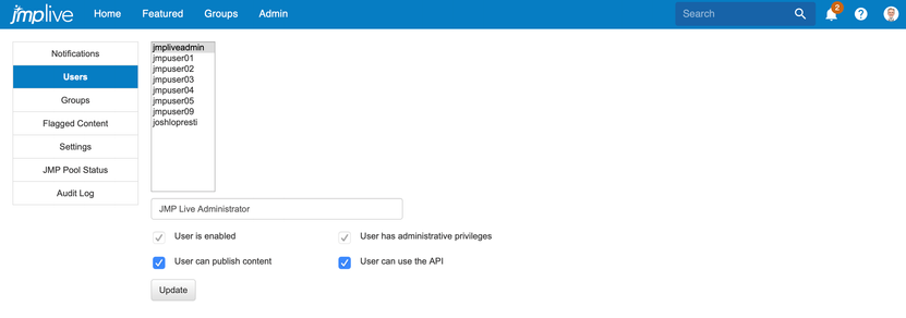

Administrating Users
Users and their respective permissions can be managed in the Users section under the Admin tab. Once you open the Users section, all of the users present within the server are listed by their username/email. There are five different edit options available to a JMP Live admin:
  1. Changing their display name.
  2. Checking and unchecking “User is enabled”:
    • This checkbox determines whether the user has access to the reports in JMP Live
  3. Checking and unchecking “User can publish content.”
  4. Checking and unchecking “User has administrative privileges.”
  5. Checking and unchecking "User can use the API."
Users section of the Admin tab, where admins have a handful of options available to them to determine user permissions.Users section of the Admin tab, where admins have a handful of options available to them to determine user permissions.
