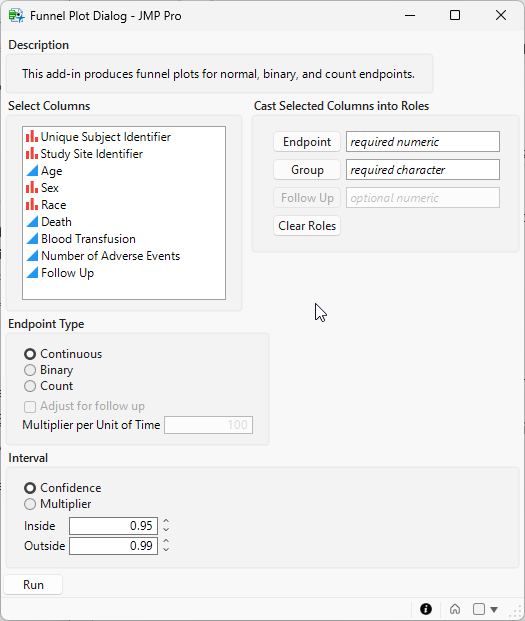

The Funnel Plot add-in in the JMP Marketplace makes the production of funnel plots easier than ever, creating plots for continuous, binary, and count endpoints, with an option to adjust the intervals of binary outcomes according to the duration of follow-up (Liu et al., 2006). Users define intervals according to specific confidence limits or multiples of the standard error (Figure 2).
Figure 2. Funnel Plot dialogFigure 2. Funnel Plot dialog
