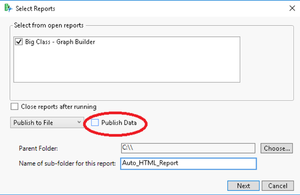

The second feature can be useful if you want to prevent data from being exported, but still want to capture some results in a web friendly format. In JMP 14, you can Publish multiple Interactive HTML reports with the Publish menu option under File. New in 14.1 is an option to not publish the data, by unchecking the Publish Data checkbox on the Select Reports dialog:
Figure 1: By unchecking the Publish Data checkbox, no data will be exported, just static images.Figure 1: By unchecking the Publish Data checkbox, no data will be exported, just static images.
This will result in a report with the styling of Interactive HTML pages – collapsible sections, tables with hover labels, etc., but all charts will be static images. This can be useful for a very large data set where you want to display a few charts, but do not want to output thousands of rows in text format. Please note that if there are too many static images, or their dimensions are too big, you could end up with a file that is large anyway. This works best for a couple of small graphs on a very large data set.

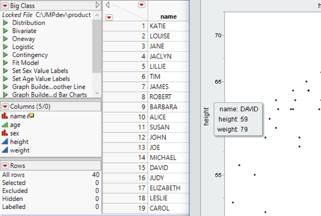

  • Labelled columns – Labeling a column in JMP is great because it will make the column appear in the tooltips provided by Interactive HTML, allowing you to explore additional information about an observation without access to the full data table. However, it means an additional column is being exported that wouldn’t be needed otherwise if it is not assigned to a visual role in the graph.  If you don’t care about seeing it in the tooltip, unlabel it by right-clicking on the column name in the JMP data table and select “Label/Unlabel” to save the space.
Figure 2 : Height and weight columns are needed in the data section since they are Y and X respectively, but name is labelled only to make it appear in the tooltip. Unlabel it if knowing the name associated with each point is not important to your audience.Figure 2 : Height and weight columns are needed in the data section since they are Y and X respectively, but name is labelled only to make it appear in the tooltip. Unlabel it if knowing the name associated with each point is not important to your audience.

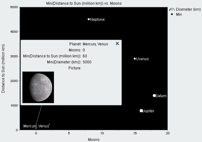

  • Images –  Image columns can look impressive in your tooltips especially if they provide value, but if it is a graph that doesn’t support image tooltips, leave out these columns. As of JMP 14.1 only markers, lines, heatmap, maps, and bubble plots support displaying images in their tooltips. While unchecking Publish Data can save you from exporting your data, the graphs will all become static images, and too many images in your Interactive HTML output can make the file large as well. Further, if an unsupported feature comes out as an image, think about if it truly brings value to the viewer or if there is a way to just turn off that part of the report through the red triangle menu or in your JSL script before exporting.
Figure 3: Markers are one of only a few visual elements that will display images in their tooltips. Do not include or label image columns if you don't want to display them or the graph type doesn't support them.Figure 3: Markers are one of only a few visual elements that will display images in their tooltips. Do not include or label image columns if you don't want to display them or the graph type doesn't support them.
