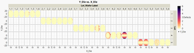

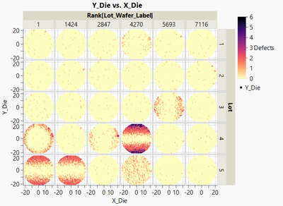

Application case for the Rank function for columns with type character :
With GroupX and GroupY enabled, often it happens that not every GroupX value shows up for every GroupY variable. Therefore there is plenty of white, wasted space. An easy trick to get rid of the space: synchronize the Y labels via rank.
before:
after:

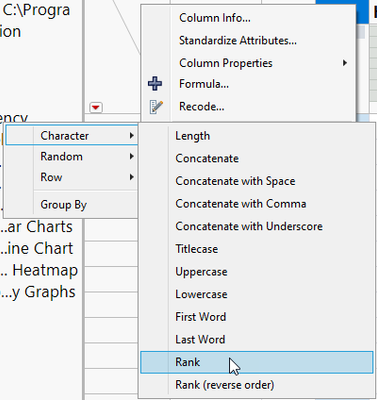

edit:
After finding Rank in the Character submenu, it's mainly Count and Cumulative Probability which are missing.
Hm, I could live without them ...

Graph Builder(
	Variables(
		X( :X_Die ),
		Y( :Y_Die ),
		Group X( :Lot_Wafer Label ),
		Group Y( :Lot ),
		Color( :Defects )
	Elements( Points( X, Y, Legend( 16 ) ) )
Graph Builder(
	Variables(
		X( :X_Die ),
		Y( :Y_Die ),
		Group X( :"Rank[Lot_Wafer_Label]"n ),
		Group Y( :Lot ),
		Color( :Defects )
	Elements( Points( X, Y, Legend( 24 ) ) )

I just found the Rank Function in the NewFormulaColumn/Character submenu :)
unfortunately, there is no Count.
