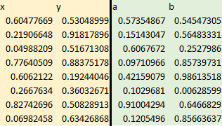

sometimes it's hard to find the right column again and again.
some suggestions to make it easier:
- define special colors for special columns (or groups):
- make the vertical line between groups thicker

right click - and change the color:
