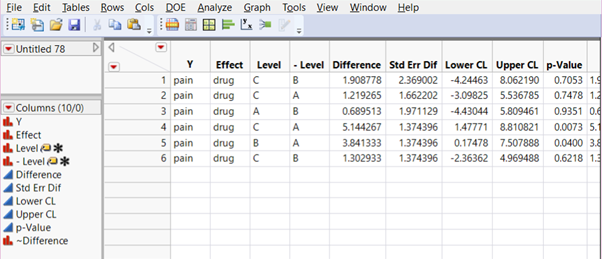

I usually do
rfm[Outline Box( "LSMeans Differences Tukey HSD" )][4][1] << Make Combined Data Table;
manually by right click on the table on the report and select Make Combined Data Table. The resultant data table follows the format as below
The values from the Where statement are not included in this combined data table. I then create new columns to fill in the missing information. Luckily, the ordering of the results is the same as the reports.
I don't know if this is the same issue or a separate problem that can be resolved with advanced scripting skills.
