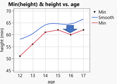

Unfortunately, Summary Statistics are just available for Point, Line, Bar and Heatmap plots, but e.g. not for for parallel or smoother plots.
This is why sometimes it's NOT possible to get a smoother and point/line plot aligned - by automatic means of Graph Builder, like in this plot from Graph Builder: Summary Statistics for Smoother
To fix the issue, one has to do the aggregation "manually" by a Transform Column.

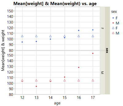

    solid points: mean via Summary Statistics -> different values for different ages, sexes + respects the local data filter
    open triangles: mean via Transform Column -> all values are the same, LDF is ignored
    One could argue: the triangles display exactly what the Transform Column is told to calculate. No need to worry.
    Yes, sure  ... if there wasn't the Summary Statistics!
    The Summary Statistics got the same task: "mean(weight)"  - and displays completely different values.

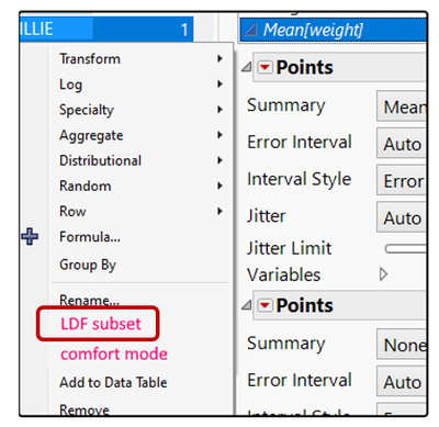

  1. For Transform Columns in Graph Builder (and other Platforms - like Summary!!!), please add an option to respect the Local Data Filter (option: LDF subset).
  2. an option which tells the transform column to split the data similar to what Summary Statistics does (individual subsets for different values on the X axis, X/Y groups, Pages ...). I called it "graph items. (comfort mode  - I am sure there is a word which describes it more precisely :)

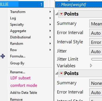

    "comfort mode":
    in the context menu add "allPlotGroups" as argument for the column aggregation to provide the same functionality as Summary Statistics. (edit: @Graph  : )

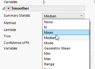

-1 argument:
smoother got summary statistics:
hogi
Level XIII
@XanGregg , many thank : )
