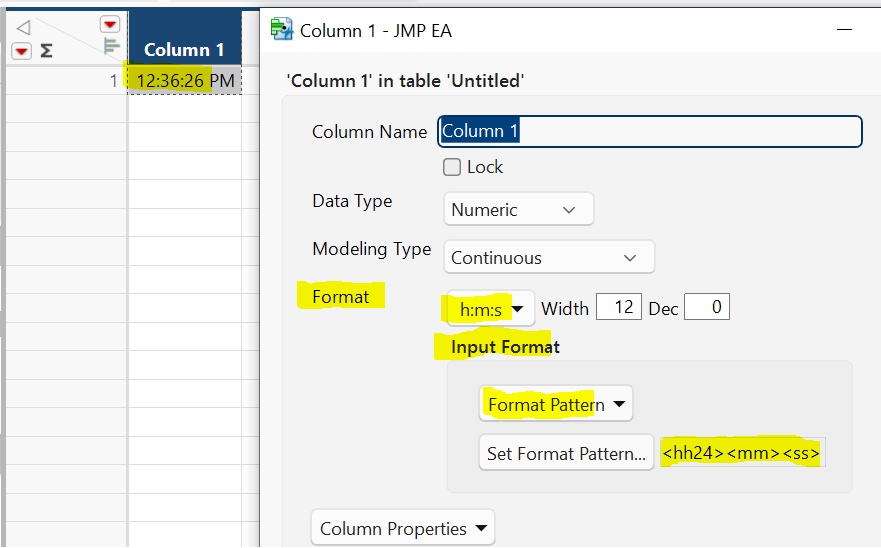

@TSMETC-B  - You would have to do something to tell JMP those digits represent HHMMSS.
JMP represents times in seconds and date-times in number of seconds since 1jan1904. 123626 is 1 day, 10 hours, 20 minutes, and 26 seconds ... in seconds.
When you read the 123626 into a data table, you either want to immediately convert it from its external character string "123626" form to a time, or you want to keep it as a JMP character column. It gets harder if JMP loads it into a numeric column as 123626 base 10, which I believe is what you've got.
Recent versions of JMP include a format pattern that can help:
I recommend using a Format (for output) with : separators and making the input format match the data.
You'll probably get better answers in the discussion forum than here.
TSMETC-B
Level I
Hi @Craige_Hales .  That works great!  Thank you for taking time to answer my question!
