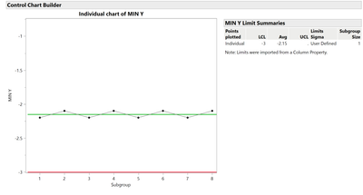

We aggregate some datasets like a 2D topology map to min and max values. If we now perform SPC on the min value, an upper control limit is not necessary and JMP / JMP-Live are at the moment not capable.
With JSL I could trigger a one-sided SPC, but this is a bug and can't be translated to JMP-Live (triage won't work on this variables)

JMP and JMP-Live are capable of handling one-sided control limits.
Why is this idea important?
At the moment, we need to set imaginary control limits that could trigger false alarms and needs additional resources to manage without benefits.

Thanks for spotting this, Mauro! You should see this bug fixed in an EA shortly.
