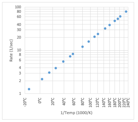

Here is an example in Excel.
I copied this from Peltiertech.com:
The x-axis is transformed so the data are plotted as 1/Temp but the values can be read off the axis as Temp.
