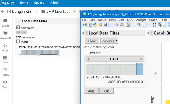

I would like to suggest an improvement regarding the behavior of Local Data Filters in JMP Live.
When posting content with a Local Data Filter on JMP Live—for example, to monitor changes between past and current data—the interaction functionality appears to be somewhat limited compared to the desktop version.
On the PC version, users can set a range for continuous data in the Data Filter and drag it to visually explore the flow of changes. However, in JMP Live, only static range selection is possible, making it difficult to observe changes smoothly.
Additionally, it would be helpful if the Data Filter could support selecting multiple ranges simultaneously.

Hello, thank you for submitting your feedback! To select multiple date ranges simultaneously, you can use an OR filter and include the variable twice in the filter with different date ranges selected. Does this address the latter portion of your request?
