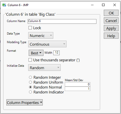

Is this what you want?

Dear Hogi,
thanks for the feedback.
The concept is OK... but the implementation not so good for me.
In this moment is not possible select the type distribution (normal, lognormal, weibull...) and it is not possible define the parameters (for example: if I want a specific average and standard deviation for normal data generation... is not possible).
So the actual menu/feature is in the correct way... but no flexible.
I hope I was clear in my explanation.
