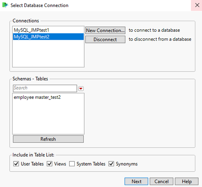

We, along with Eric Hill, discussed this at JMP Summit this fall.  I have upgraded to JMP 17 and ODBC driver to 8.0 ANSI driver.  I created 2 System DSN connections using the new driver to each schema within the server.   I can load both DSN connections into Query Builder but cannot choose a database from one connection and join it to another database in the second connection.  JMP 17 Query Builder does not allow for multiple connections.  I find this very odd. The next screen (Query Builder) shows only the tables within the highlighted DSN connection.  Any thoughts?

The issue here is that the query is actually being done in the database, not in JMP. Since you're using two different DSNs there is no database to submit the query to. The two databases don't know about each other and don't have access to the same schemas.
The only way that could work is to bring both tables completely into JMP and have JMP execute the query. In fact you can can do that by bring ALL of the two tables from the two different databases into JMP as tables and then use the JMP Query Builder (which runs against JMP data tables) to build the query.
