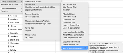

The old Multivariate Control Chart platform implements a Change Point Detection, but that platform has been deprecated in JMP 17. A paper at Discovery this year showed how useful this functionality can be.

Hi @andrewtkarl , the old Multivariate Control Charts platform is still there in JMP 17 (and also JMP 18), so Change Point Detection is still available.

Hi @andrewtkarl, the old Multivariate Control Chart Platform only detects one change point. We'll research a new method to detect multiple change points, or potentially implement the old method in MDMCC.

Hi @mia_stephens , yes that works, thank you, just as long as the functionality is preserved past JMP 18 as well (I asked in case the deprecated platform goes away in the future, just thinking ahead). To your second point, that would be helpful as well. I wrote my own script based on the code shared from that Discovery presentation that iteratively extracts the changepoint and excludes everything up to that point and then recalculates the next changepoint and it works well.
