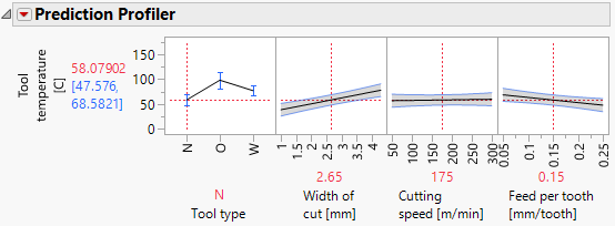

Quick note for other JMP users. There is a workaround to visualize at least prediction intervals in the Prediction Profiler.
Save the PredSE Formula and add the MSE to that formula (see picture below with the example of 9.1816). Select both columns (PredFormula and PredSE) in the Profiler and you get an approximate 95% PI.
You have to manual adapt each PredSE formula and that can be time-consuming in cases where you have multiple responses.

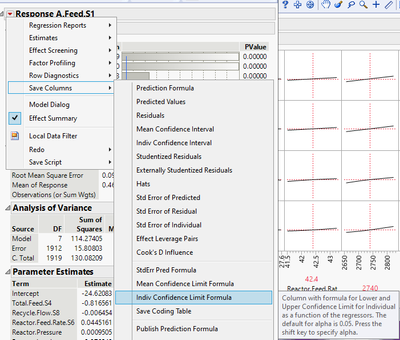

@Marco_ I believe you can export this formula directly from some platforms such as fit model (see below screenshot), but I agree it would be nice to see that as shaded regions right in the profiler.

@ih
Thanks for the info. What you need to export is the StdErr Pred Formula. However, both export tools (StdErr Pred Formula and Indiv Confidence Limit Formula) only gives you the Confidence Interval instead of the Prediction Interval. Thus, the manual adaption is necessary until JMP implements this.
