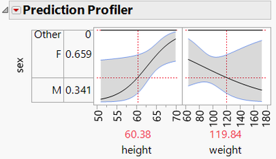

Are there any updates? I saw that the Generalized Linear Mixed Model has some of this functionality. You can save the "Prediction and Interval Formulas." You get the better picture although you don't see the numerical values at certain combinations (see below). Will this be possible more broadly, say in Generalized Regression?

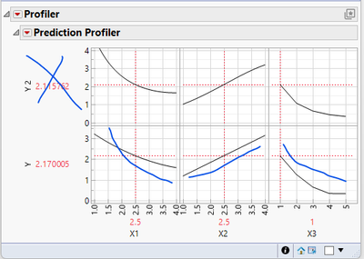

 I can effectively use the Graph -> Profiler menu to overlay those models.
Is there a trick ?
Overlay profiler from two different models
jszarka
Level V
@hogi  - I'm afraid that my use of 'overlay' doesn't match what's in your thread. I meant in my case that you can have multiple profilers from different types of models, like logistic regression and ordinary linear regression. Having literal prediction equations on top of one another in the Profiler is an interesting request as well. The suggestion there on the residuals column seemed reasonable because concepts like desirability functions and the Simulator tool can be used to see how far away from zero the difference in models could be. Hope it works out!
