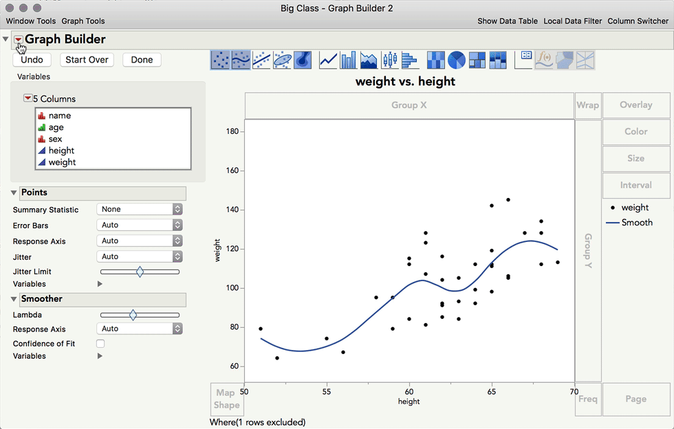

Row Hide and Row Exclude are independent for most platforms other than Graph Builder. But, there is a hidden option to show excluded rows in Graph Builder: while holding shift, click the Red Triangle > Show Excluded Rows. The excluded rows will now show on your plot as slightly transparent.

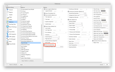

By the way, there is a preference you can set to always show excluded rows in Graph Builder. Preferences > Platforms > Graph Builder, Show Excluded Rows.
