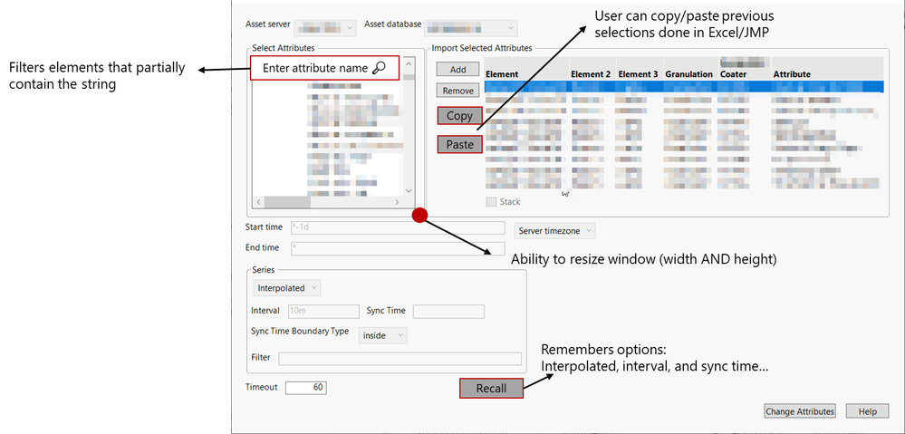

PI Server AF connector improvements
The PI/AVEVA connector is substantially improved, enabling JMP to be used in manufacturing datasets.
PI AF databases have multiple elements. The window to select Attributes cannot be resized properly.
In addition, we need to be able to search the data using a bar to filter elements.
Last but not least, users should be able to copy and paste the selection done in a previous moment, so the work does not need to be repeated.
Similarly, keeping the previous options in memory will help with new extractions (or by having a recall button)

Great. The hard job is done already.
Hopefully, the UI/UX improvements can be prioritized, making JMP the perfect companion for PI historians.

After some more tests:
- Update doesn't add new rows. Instead, downloads the whole period again (duplicating values in the main table).
- Once the data is extracted, the script change attribute did not working either
- It will be nice to extract both server time and UTC (having two columns in the table)
