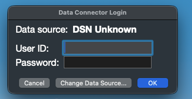

When a user opens a .jmpquery file, and it contains an unspecified Connection to an ODBC DSN, a Data connector Login dialog opens, and one option is to "Change Data Source..." If the user chooses this, they are brought to the ODBC data source panel, and If the user has already opened one or more ODBC DSNs, then they can choose to try to run this file and its queries with the already opened DSN.
If, however, there is a .jmpquery file and it contains a Connection to Snowflake REST API (or another OAuth based connection), as of JMP version 19.1 it always prompts for a new OAuth login. This means that someone who has logged in to a connection, may have to repeat this login for every file they would like to open and run against their active Snowflake connection.
