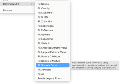

What inspired this wish list request? Occasionally I come across a data distribution that I need to calculate a spec limit for and the non-parametric fit is the only one that works well.  I can fit this distribution a couple of different ways but only the Legacy Fitters in the Distribution platform under Smooth Curve allow using a K-Sigma Multiplier to find the appropriate spec limits for a desired Ppk.
This fir is not as polished and I'm sure at some point will go away.
What is the improvement you would like to see?
Please add the Non-Parametric fit to the options under "Continuous Fits" in the distribution platform.

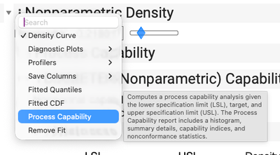

Hi @shampton82 , thanks for submitting this request. Have you tried Fit Smooth Curve, available from Continuous Fit? This uses nonparametric density estimation for computing spec limits and estimating capability. It also has a sigma multiplier option.
Results should be equivalent to Smooth Curve under Legacy Fitters. That said, we nave no current plans of removing the legacy fitters.

Oh man, not sure how I missed that.  This works great, I am good to go.
