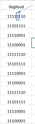

Hi, I have been trying to find a way to read one bit in an 8-bit code (column RegRead) to be used to create a new column.
I can't seem to know to do it. in this example below, I am trying to ready bit[3], can someone help with it
much appreciated.
Ray

As an alternative to @Jeff_Perkinson 's suggestion, you could use the built-in functions Hex and Hex to Number:
Hex( 3, Base( 2 ), Pad To( 8 ) );
Hex( 3, Base( 2 ), Pad To( 4 ) );
Hex To Number( "0011", Base( 2 ) );
Regarding single bit access, there is no function available at the moment.
Please follow this link and support the wish with a Kudo:
JSL bit operations
