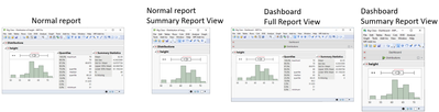

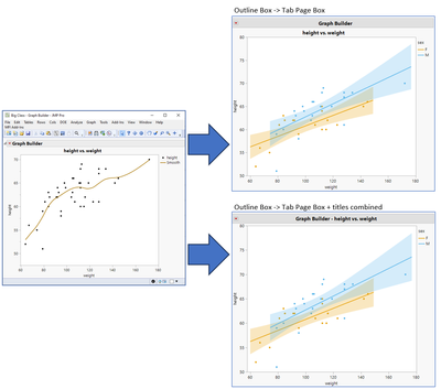

JMP reports utilize a lot of outline boxes with red triangle menus in reports but dashboard uses tab page boxes. I prefer the look of tab page box unless I want to be able to collapse the highest level of report. Below are few examples of current implementations in JMP

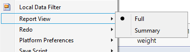

JMP does offer Report View options (currently Full and Summary).
Add new option ("Dashboard"?) which would change the top-level Outline Box to Tab Page Box (even better would be if in graph builder "titles" could be combined but this is most likely separate discussion)

Example script how Outline Box can be "changed" to Tab Page Box while scripting
Names Default To Here(1);
nw = New Window("Dashboards",
	H List Box(
		tpb1 = Tab Page Box("Graph Builder",
			gb = dt << Graph Builder(
				Show Control Panel(0),
				Variables(X(:weight), Y(:height), Overlay(:sex)),
				Elements(Points(X, Y, Legend(9)), Line Of Fit(X, Y, Legend(11)))
		Spacer Box(Size(20, 0)),
		tpb2 = Tab Page Box("Distribution",
			dist = dt << Distribution(
				Stack(1),
				Continuous Distribution(Column(:height), Horizontal Layout(1), Vertical(0))
gb << Title("");
tpb1 << Set Scriptable Object(gb);
tpb1 << Set Base Font("Title");
// Optimal case, you could hide "title"?
graph_titlebox = Report(gb)[TextEditBox(1)];
graph_titlebox << Visibility("Collapse");
// and maybe move it to the proper title
tpb1 << Title("Graph Builder - " || (graph_titlebox << get text));
dist << Title("");
tpb2 << Set Scriptable Object(dist);
tpb2 << Set Base Font("Title");
Write();

For tall reports, where a user has to scroll down to get the full content,  Outline Boxes are quite useful, becuase they  act as sticky titles.
John Sall explains the concept @ 15min in  .
For "wide" reports with a more complicated structure, Tab Boxes fit better :)
Especially if there is no need to scroll down to reach further content.
Using @jthi example and scolling down, one sees that "height" sticks (as it's an Overlay Box)
and the other titles disappeared (as they belong to tab boxes).
danschikore
Staff
As @hogi suggests, sticky titles are the big benefit of Outline boxes as general platform containers.  Dashboards wrap the platform in both a TabPageBox *and* a ScrollBox, as an alternate view.  The TabPageBox in the Dashboard case also functions as the drag/drop and maximize/restore mechanism for rearranging the reports.  Note that the platform OutlineBox is not actually replaced, but it is suppressed, similar to what @jthi demonstrated in the scripted version.  Stretching is also a factor when combining reports like this, as the scripted example does not stretch the Graph Builder window.  The Dashboard use of SplitterBox and ScrollBox help to retain the stretching/scrolling behavior of each report.
