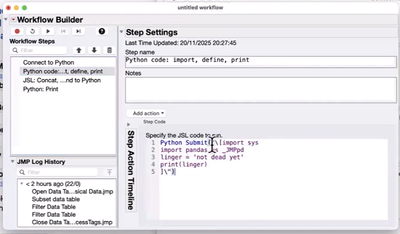

Please allow Workflow Builder to accept JSL and Python code.
At the moment, the Workflow GUI asks for JSL code:
Just add an option to choose between JSL and Python (or any other code which is allowed ...)

JMP Notebook -> Send to Workflow:
cool!
- but via Python Submit() ? Hm ...
from: Using the Latest Enhancements to JMP and JMP Pro  / @brady_brady
Take a look at JMP Notebooks and start dreaming about Workflow Builder 2.0 --  which will offer genuine Python support.
