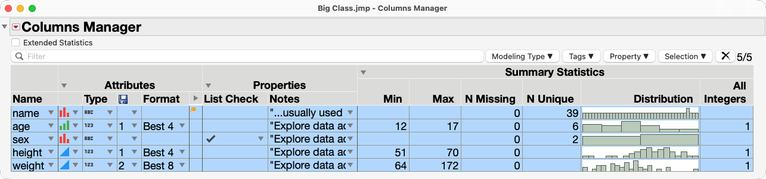

I wonder if the Columns Manager is sufficient here? It shows the Subtypes and allows updating them.
Here's what Columns Manager looks like for Big Class after Cols->Utilities->Compress Selected Columns:
