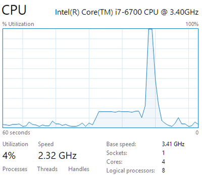

I've included another example below which finds the largest file in a list of files using multi-threading. The script runs a single-threads version first, and you can see both spurts of activity in this task manager screenshot. The single-thread version is the long mesa and the parallel version is the tall peak. For 17,000 files on 8 cores, the time went from 13s to 4.5s, or 3x faster. Not ideal, but as is often the case, the threads are sharing some resources, such as the disk access in this case.parallelfilesize.pngparallelfilesize.png
The JSL that executes in parallel does need to be simple so that it doesn't modify the shared global state. That's why some globals are copied in as the first step. It also means that the parallel code can't do things like create data tables or interact with the display.
