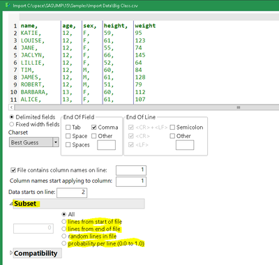

Take a look at the random sample options from the other csv import so this can look similar.
I think there is a request to ignore comment lines identified by a prefix, as long as you are in that code.
hogi
Level XIII
ah, thanks, even more options that make sense.
a pity that the options are just available in the open csv dialog:

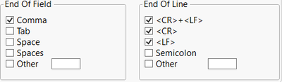

So perhaps, in addition to
- End of Field characters
- End of Line characters
Jmp could ask for a
- end of DATA block character sequence
e.g.: data block ends if there are 2 consecutive newLines:
MFI (<< end of DATA block("\!n\!n"))
