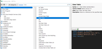

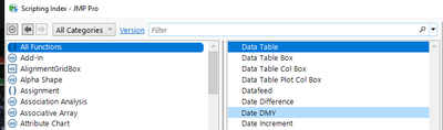

and I wish to know what I could do with data tables. So I hold ctrl and double click on the data table.
Now if I click on the Data Table I would like to get the category updated (or even better, it should be updated automatically based on first match?), but it stays All Functions. So what I always have to do, is to write Data Table to Filter
Click again on the exactly same message Data Table and then it will update Category (not exactly sure why it is Row instead of Data Table but it is still better than All Categories).
Now I can select the Row() category (or just clear the search) and I will get nice clean list of different operations related to the category
