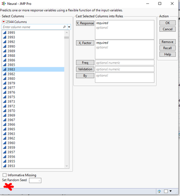

  • Adding a radial option in model gui for the applicable algorithms.
    • I think the easies option would be to include a radial option on the amenable algorithms (NNET and Tree-based etc.) that would let the user select if they want all the response parameters to be modelled collectively vs. independently.
    • I think there was an option similar to this for how jmp handles multiple response parameters back in JMP 13 (maybe still included in JMP 15) but its an option that seem to have been removed.
