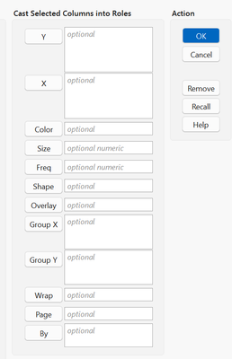

Some of the graphing options (i.e. BY) are not available at the initial GRAPH BUILDER screen.

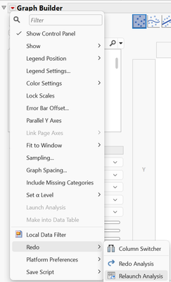

JMP Tech Support identified that you can get to the interface that has the "BY" by going to REDO->Relaunch Analysis
Why is this idea important?
In it's current location, most end users are not even aware this interface exists or that it is possible to use BY without manually coding it in a script.
