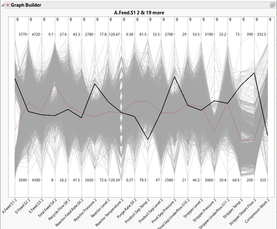

What inspired this wish list request? I'm using the multivariate platform more but understanding what is driving out of control points is not an easy task and there are different features in the MDMVCC vs the norma Multivariate control chart platforms that would be nice to have live in the MDVCC.
What is the improvement you would like to see?
  • Be able to save out T^2 values and T^2 formula
  • Have options to highlight out of control rows
  • Have an option to add an out of control row indicator column
  • Add a parallel plot option with mean curve (like Multivariate)
    • Add ability to show the average of the selected groups or selected out of control points
    • Show the mean value (red in this example)
    • Be able to add groupings that will show up on parallel plot from the score plot (currently can do group A and B, add in up to n items)
  • Be able to have stages like control chart builder
  • Have red bars on mean contribution charts that at least one of the selected samples was out of control on the univariate chart. (vs current meaning that the average is out of control)
  • Add in the change point detection option we have in Multivariate control charts
Why is this idea important? These options will allow determining what is driving out of control situation to be an easier task as well as allow staying in one platform vs having to jump between MDMVCC and MVCC platforms.
