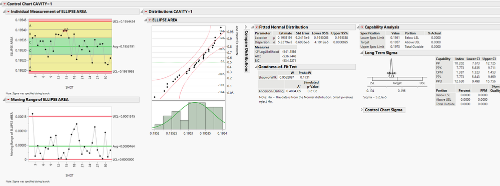

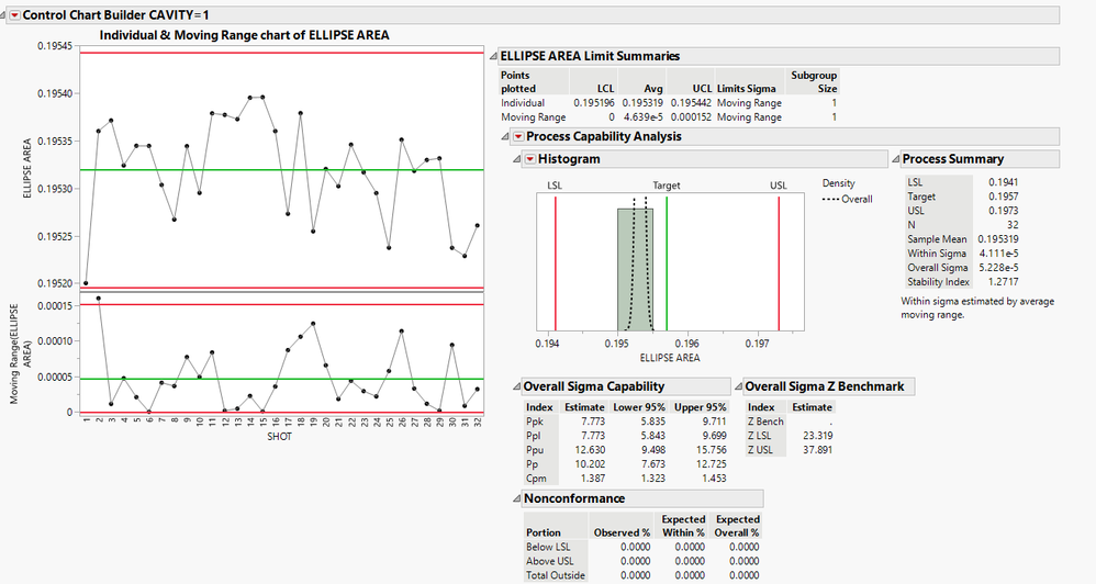

Sorry for the delay on responding to this @mia_stephens. Below are the charts i am referring to.
Yes, I am requesting the normal quantile plot as well as goodness of fit options to be added to IMR chart in control chart builder.
Legacy IR Control ChartLegacy IR Control Chart
IMR ChartIMR Chart

Hi @AlexEdmunds , yes, the normal probability plot has been added for both XBar and IR charts. Does this satisfy your request?
AlexEdmunds
Level I
Hi @mia_stephens , although the normal probability plot is a nice step forward, it doesn't quite cover what I was hoping for. I'd love to see the Shapiro-Wilk and Anderson-Darling goodness-of-fit tests added, like we had in the legacy control charts. Also, being able to fit other distributions would be super helpful.
When presenting process capability, we need to show both stability and normality. The Control Chart Builder handles stability great, but it's missing those key goodness-of-fit details for normality and other distributions. Having these in one place would make analysis quicker and clearer.
