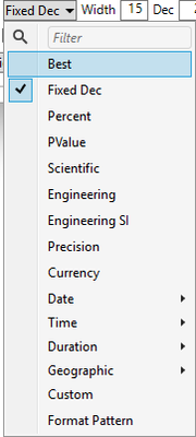

The current issue exists with no formatting options outside of decimal precision for control chart limit labels. With large numbers, limit labels become unreadable without the option to use scientific formatting. The formatting that you set in the column or in the control chart axis are not respected or consistent with limit labels.
What is the improvement you would like to see?

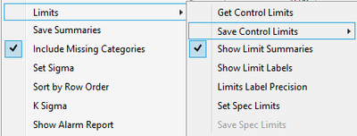

1) An additional red box menu item should be added to Control Chart - Limits
- Limit Label Format
Which shows the same Menu option as in the column
2) The formatting selected in the column properties should be carried over to the formatting of the Limit Labels in Control Charts

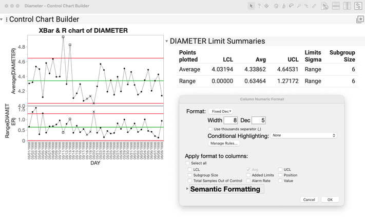

Hi @StephenBolton , I believe the functionality you request is currently available if you double-click on the limit summaries table. You can select column formatting and apply it to other columns. You can also use Semantic Formatting to apply these formatting changes in future graphs.
I hope this helps!
