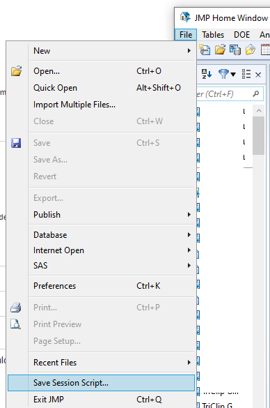

The best way for me to not lose work is by saving a Session Script intermittently throughout my session:
I then open and run the saved .JSL script after JMP crashes and viola! I'm back where I left off....

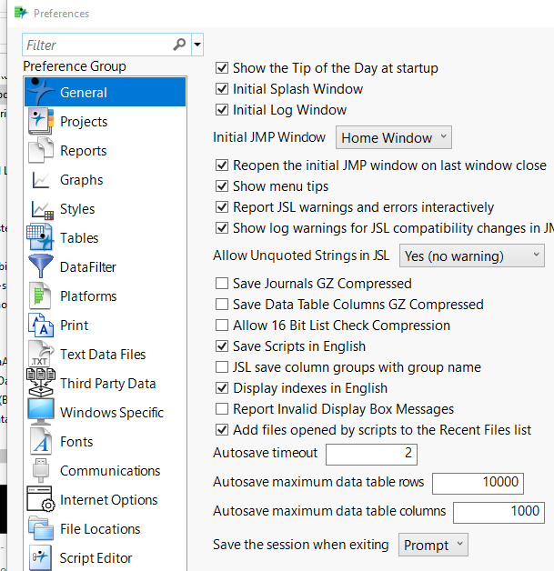

Otherwise the Autosave Timeout is supposedly a good option (File > Preferences > General; see below), but it doesn't really work for me even if I set it to some reasonably short interval such as 2 or 5 minutes.

Saving the session script is a great idea though, I'll have to start doing that!
