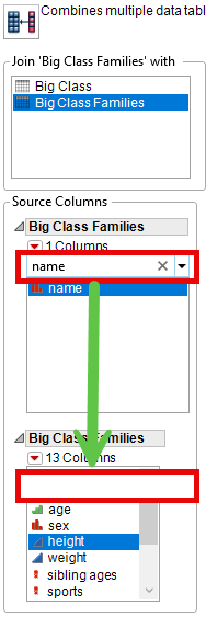

What inspired this wish list request? When joining 2 tables, only the first table has a column search field for the colimn, but not the second table.
To have a column search field for both tables i want to join.
Why is this idea important? It will speed up the join operation at files with a lot of columns and would be a more consistent design.

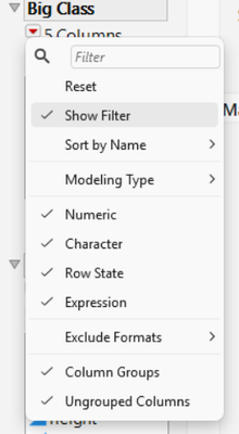

you can always enable the Search via the red triangle menu.
Interesting why your first menu shows it by default?
My favorite default: enabled!!!
... for Join and Update
