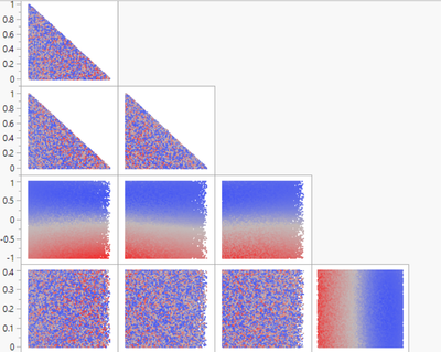

I use it many times and it really is a great feature! When I create a scatterplot matrix based on simulated data I like to filter my data. I can do this also within the HTML file output with the mouse by drawing a rectangle across the data points.

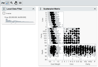

@Marco_ , to enable selection with the Local Data Filter as you described for the scatterplot matrix in the Interactive HTML version, you can disable both the Include and Show options before exporting. Then, the Interactive HTML Local Data Filter will select points chosen by the continuous (or categorical) filter rather than show or include them.
Here's a screenshot of the diamond's priced between $3000 and $4000 selected via the Interactive HTML Local Data Filter using the Diamonds Data.jmp sample dataset:
The Local Data Filter's menu in Interactive HTML will allow you to switch between selecting and showing the filtered rows in graphs. These are operations we can perform in Interactive HTML without the full calculation power of JMP.
