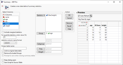

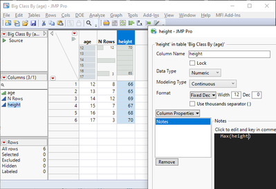

When creating new tables with Summary, provide option to add Notes (or some other) column property to generated table which tells which options were used for that specific column. This would be especially useful when using "statistics column name format" option "column".
The most simple implementation could be something like this
Why is this idea important?
I like using Summary with "statistics column name format" option as "column" but from time to time I might forget which Statistic I used, this way I could quickly check what the statistic was. This also moves JMP a bit towards an idea where you could use column properties to store metadata (I will write my own add-in for this when I have time).

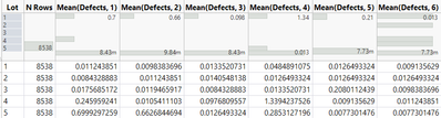

This will also help to make SubGroup more understandable.
Sometimes, I use hierarchical subgroups with 1=yes, 0=no. Almost impossible to understand after 2 days.
If then, in addition a Table/Update kills your source script (Table / Update - source script collision  ), you are completely lost!
dt =Open( "$SAMPLE_STIPS/Wafer Stacked Small.jmp" );
dt << Summary(
	Group( :Lot ),
	Mean( :Defects ),
	Subgroup( :Wafer ),
	Freq( "None" ),
	Weight( "None" )
