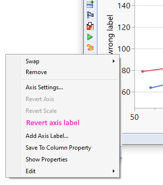

Sometimes a user wants to revert a label and cannot do this:
  1. In Jmp there is a severe bug: after a manual change of an axis label,when you add or remove subplots, this label doesn't stick to the respective axis - the label sticks to the "position": Manual axis labels are 'mixed up' when plotting multiple columns
  2. If a user deletes the text label, he has no access anymore to the label - so: no possibility to edit the label.

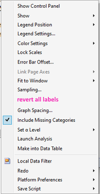

Please add commands to revert labels:
a) revert a specific axis label
b) revert all labels of the Graph.
