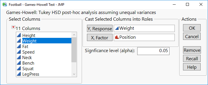

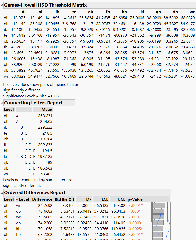

No movement on this yet from what I can tell, but I started creating an add-in for it recently.  Right now, I have it functioning for X and Y inputs, but hope to incorporate a By variable when I get a chance.  You can try it now if it would be helpful for you.  Here's a snippet of the dialog and report.  Feel free to PM me and I will send it to you.  Recall and Help buttons are also non-functional right now.GH Dialog.pngGH Dialog.png

**Update:  I uploaded an add-in version of my application to the File Exchange: Games-Howell Test (Tukey HSD with Welch's correction for Unequal Variances)
