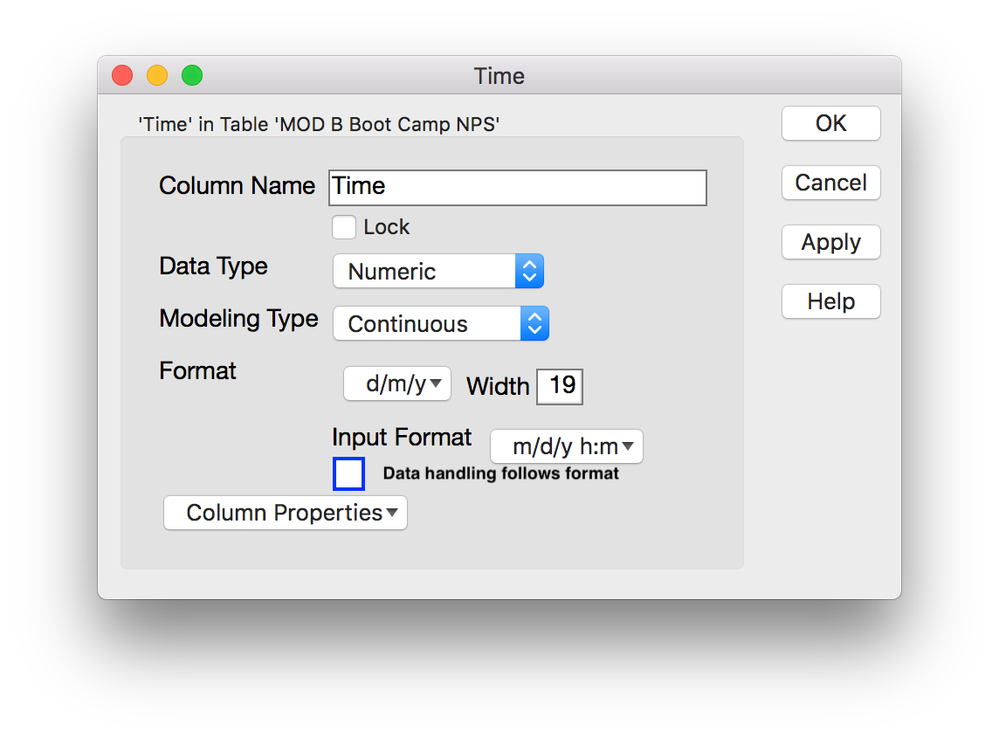

How about expanding the idea that data handling follows data format.  If I have timestamp data and I format the column to day/month/year, JMP could automagically ignore the time portion of the data when handling it.
The use can be expanded.  I am old school and learned about significant digits in science classes, unfortunately the computer science majors were absent that day and as a result the constanly spit out data files with 8 or 10 digits of precision because well we can.  Again only the first three are really useful.  I can create a column and do the truncation but what would be a wish (get it) is to just set the format and have the anaylsis use that format.  For example if I have a bunch of data 98.12345543, 98.2234454,... and really it is good to 1 decimal point I can set that in the format, but it is still handled as 98.xxxxxxxxxx.  There are often times I use numeric values in nominal/ordinal ways and then I need to create a column to truncate.  I just want to move faster.
