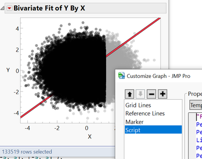

  1. In JMP12, the order of objects was obeyed in the FrameBox -> Customize... (the right-click menu).  Specifically, when having rows selected, those selected points could be drawn over by any added graphics scripts that were listed after them in the list.  Starting with JMP14 (I never used JMP13, so I can't speak for it), selected points are drawn on top of every other thing.  This is problematic when dealing with many thousands of points and not being able to show trendlines or any other object above the points if they are selected.
    1. This really comes into play when a user selects a category in the legend and the points become selected -- suddenly the user cannot see the lines!!
    2. see below for some code showing this

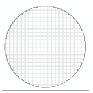

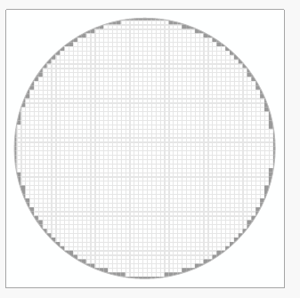

  2. Also when drawing a grid (I do this for displaying die within a wafermap) on a GraphBox the grid is not anti-aliased.  When copying the image to a clipboard, again the image is not anti-aliased.  JMP12 would do the anti-aliasing and the images looked much better!
    1. see below for a comparison of JMP12 and JMP14/16 anti-aliasing
Example issue with selected points above all other possible elements:
Names Default to Here( 1 );
table = New Table( "test table",
	Add Rows( 150000 ),
	<<New Column( "X", "Numeric", <<Set Each Value( Random Normal() ) ),
	<<New Column( "Y", "Numeric", <<Set Each Value( Random Normal() ) )
Eval( Eval Expr(
New Window( "Test",
	<<On Close( Close( Expr( table ), No Save ) )
	Platform( table,
		ob = Outline Box( "",
			Bivariate(
				X( :x ),
				Y( :y )
(ob[Frame Box( 1 )] << Find Seg( Marker Seg( 1 ) )) << Set Transparency( 0.4 );
ob[Frame Box( 1 )] << Add Graphics Script(
	"FAKE_LINE_OF_FIT";
	Pen Color( "Black" );
	Pen Size( 4 );
	Line( [-5, 5], [-5, 5] );
	Pen Color( "Red" );
	Pen Size( 3 );
picture of issue:
Line should be drawn on-top of the data points.

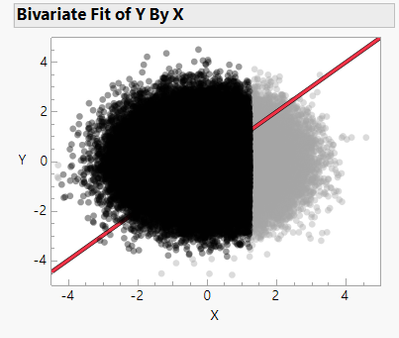

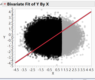

JMP12 would draw in the correct order:
Anti-Aliasing examples:  (note that these are fake wafermaps that demonstrate my point)
JMP14/16: PrintScreen:
JMP14/16 CopyPicture:
JMP12 PrintScreen:
JMP12 CopyPicture:
