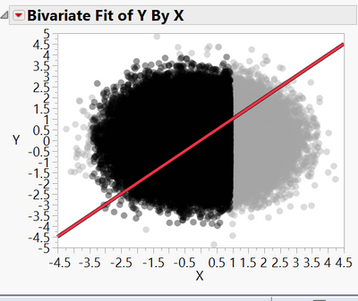

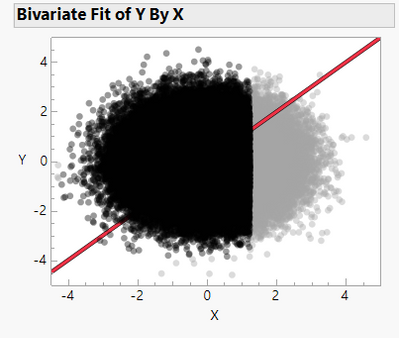

JMP16:
JMP12 (marker segs are drawn FIRST)

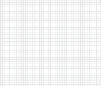

And here is an example of the aliasing issue (the background grid is a regular grid of lines):
JMP16:
JMP12 (aliased properly!):

@XanGregg , Thanks for the response!  I was thinking that the Marker issue was due to JMP12 and prior sometimes obscuring selected points behind unselected points.  It is good to show them of course, just not above all other elements.

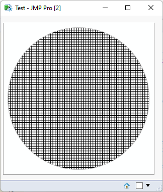

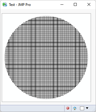

This is the result I get on JMP17.0.  Not only are there superfluous thick lines visually appearing, but the individual squares are not consistently sized.  This is the type of display issues that happens when no anti-aliasing is performed.  I don't have JMP12 installed on my machine any more,

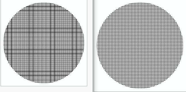

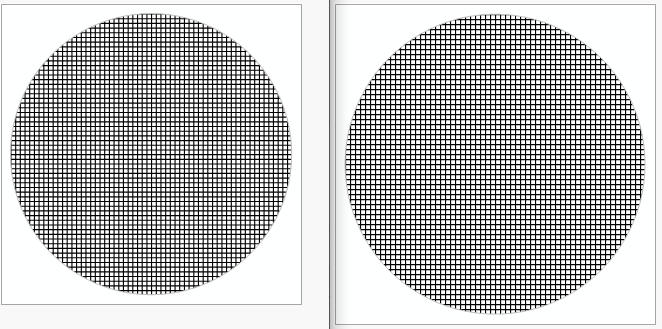

Thanks, I can see the issue now. It looks like our Windows drawing layer is making an "optimization" and turning off anti-aliasing when all the path segments are rectilinear. I don't know the details, but I think part of it is avoiding fuzzy rectilinear lines. So one hack would be to insert a small diagonal line into you path, such as "m0,0 l0.01,0.01". Then JMP 17 will behave like JMP 12.
However, I notice your graph is size 300 and the scale spans -160 to 160. If you can make the graph size 320, both 12 and 17 will look better since the anti-aliasing is not needed (+/-1 pixel maybe).
JMP 12: 300 vs 320
JMP 17: 300 vs 320
